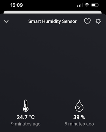

The application has been validated, and tested on three different Homey gateways:
  1. Homey Pro 2023
  2. Homey Pro 2019
  3. Homey Bridge
On all three of them - the Humidity Sensors are working, and reporting correctly, as you can see below:
