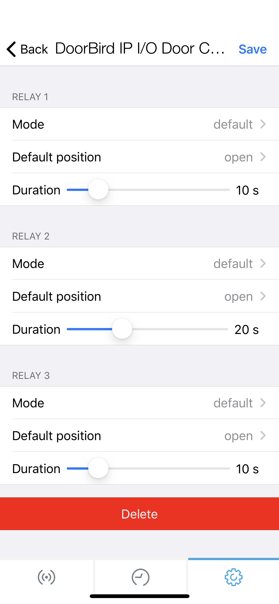

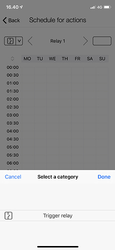

There is no schedule option. I am using the relay controller as I wrote earlier. For the built in relays which I’m not using there isn’t an HTTP call option under schedule. See screenshots attached.
There does not seem to be any api documentation for the door controller so there is no way for me to build support for it.
