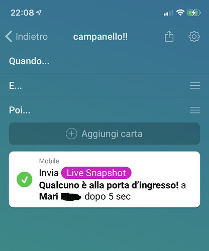

Sorry for bothering again:
I have a strange problem.
My fiancè gets the live snapshot when the dolrbird motion sensor is triggered but I don’t get it.
What is happening?
No idea but since it works for you it’s probably not an issue in my app but with the sending of the snapshot to the mobile. The snapshot in itself is fine.
