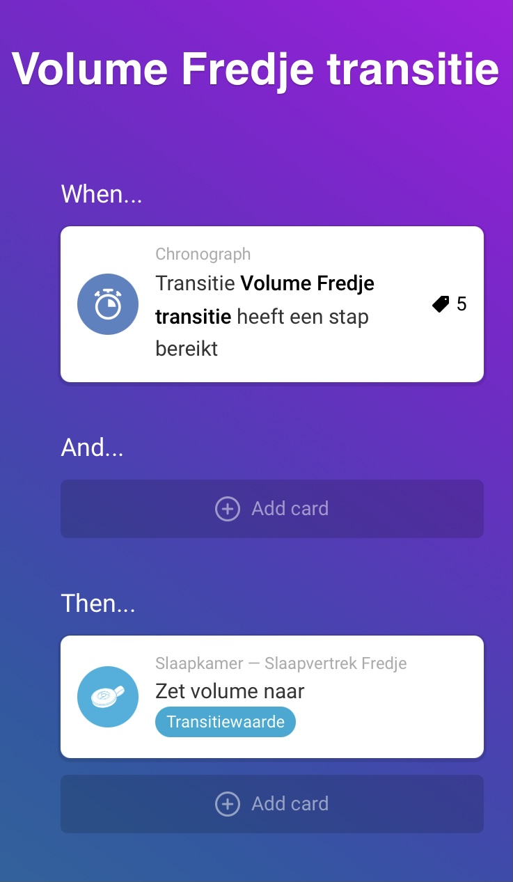

Why isn’t this working?
Je gebruikt maar 1 stap voor de transitie, dus ergens binnen die 5 minuten zal de waarde in 1 keer van 0 naar 85 gaan. Daar kan je beter 85 invoeren ofsow zodat de waarde in 5 minuten in hele stappen van 0 naar 85 zal gaan

He explained the flow above has only one step. So somewhere within 5 minutes the transition starts from 0 to 85, but as mentioned, only 1 step… there for he should increase the number of steps.
Bedankt JW
Thnx JW, small adjustment made working like a charm now

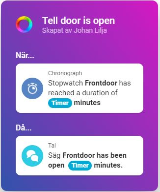

Hi!
Thanks for a great app that I use a lot, but now I have got a problem.
I try to use a variable as input to a stopwatch. But when I do this, Chronograph crashes immediately when the stopwatch is about to start (a door opens). The variable is set up as a number field.
Is this a known issue or can I provide additional information?

I can confirm that this make the app crash.
