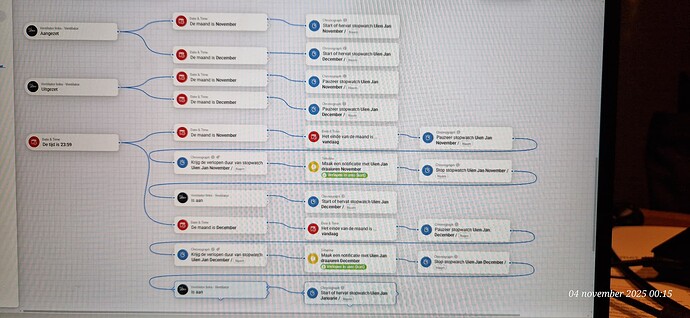

In the bottom flow you stop (also reset )the stopwatch.
So when you later read out the value it will always be 0:00:00
You should pause; read out; save; stop
You are probaly right about that, but i did not get a timeline notification. Not even with 0:00:00 so for some reason it doesnât send any data
After you stop a stopwatch it is not possible anymore to retrieve the run time. As such that card will fail (the error will state that the stopwatch is not running) and the next card (posting a timeline message) is not executed.
In the first screenprint there are two cards âpause stopwatch uienâŚâŚ.â That suggests that there are at least two stopwatches starting with âuienâŚ.â But when you type âuiâ in the searchfield no existing stopwatches are listed. Apparently the stopwatches donât exists
Try to create the stopwatch again: select a new âstart stopwatch-cardâ; fill in the name in the choose-field; select new. Save the flow. Start the stopwatch with the new card. Check if the stopwatch is running in the Chronograph-app settings. If so try to pause the stopwatch. Check in the app-settings whether the stopwatch is paused. If not, delete that card and recreate a new pause-card. And so on.
Shouldnât it be that the first card with for example Uien has made in the field ânaamâ. When that is done and you want to use that stopwatch, then you have to choose in the other card for âKiesâ.
(Or this is changed in a update that i do not remember).
For new stopwatches it suffice to use the âkiesâ-field only and select new. The ânaamâ-field is still there to keep cards that where created long ago working.
Yes, indeed!
