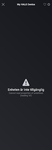

Hello. I’ve gotten the API-key, and followed instructions. Still I get the error according to my attached file.
What can I’ve done wrong?

You were right.
I used my admin e-mail instead of my user e-mail.
Thank you for outstanding support with quick replys!

This could be caused by two things as far as I can see:
Either your API key hasn’t been activated yet (normally is done when they send out the API key but have heard of others who had issues).
The other and more likely problem is that there is an error/mistake in the email/password/APIkey that you have entered in the settings.
