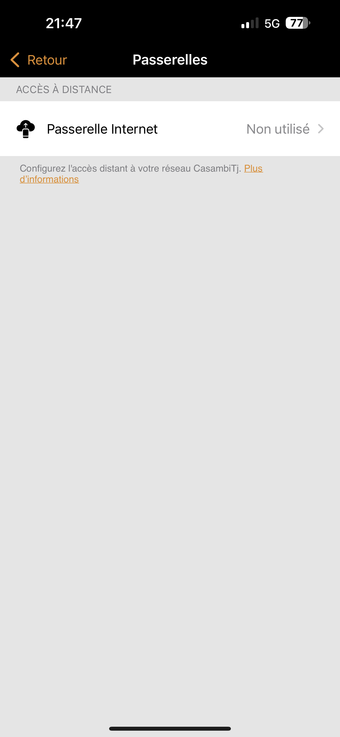

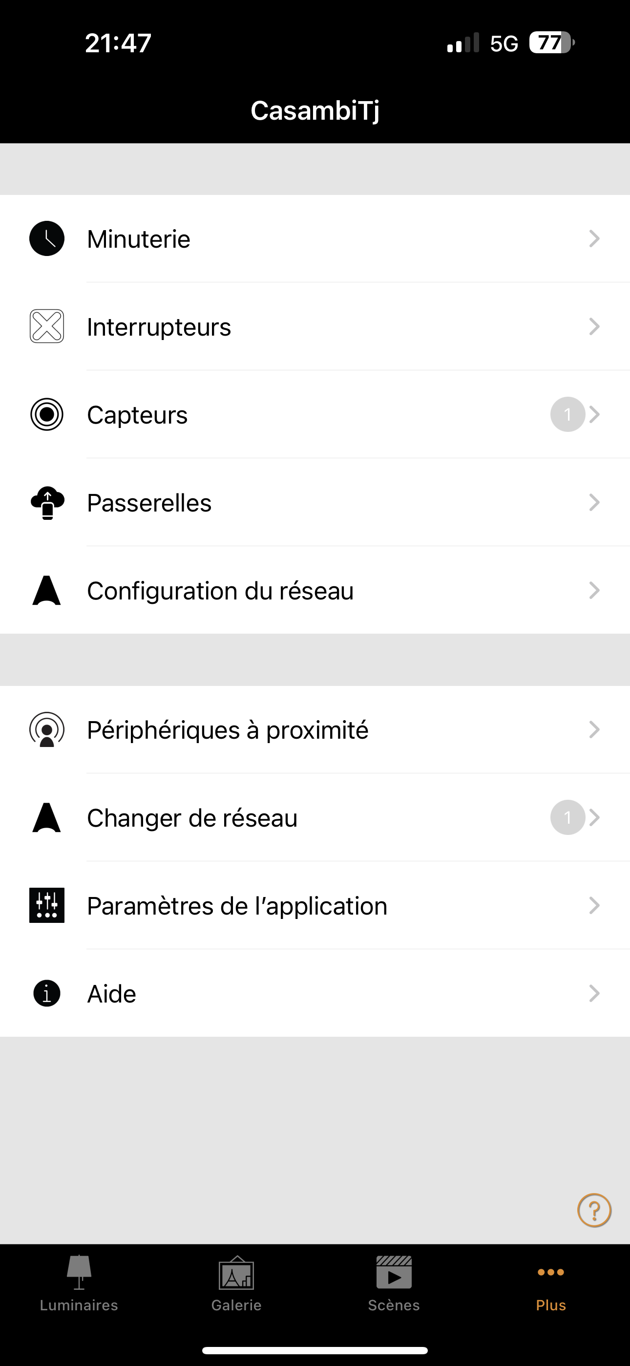

Hi Ninja Menu, I do have a Homey Pro too but I can’t control my lights via the Homey Pro application. I do see them in my app, just like you did. How did you activate the gateway?
This is done in the casambi application on your phone. Attached are the screens for an iPhone;Bottom left, “More…” menu, then “Passerelle” then “Passerelle Internet” then “Cet appareil”, back twice. Let me know if it works.
