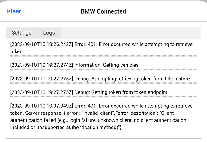

Hello, is there already someone busy with the âBMW Connectedâ App itself? Thanks!
@rstroot can you try changing the password and try again.
@Dennis_van_Zelm Is there a specific issue you are facing?

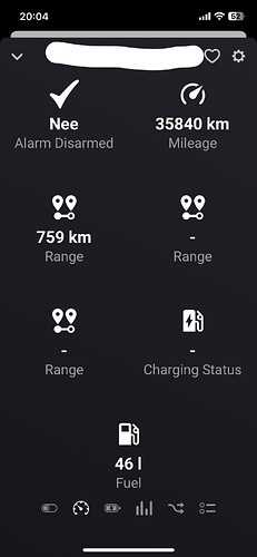

Hai Lichan. The amount Refueled donât work anymore.It is missing a token and the location no longer works either
@Dennis_van_Zelm seems like you are not using email address for your username.
