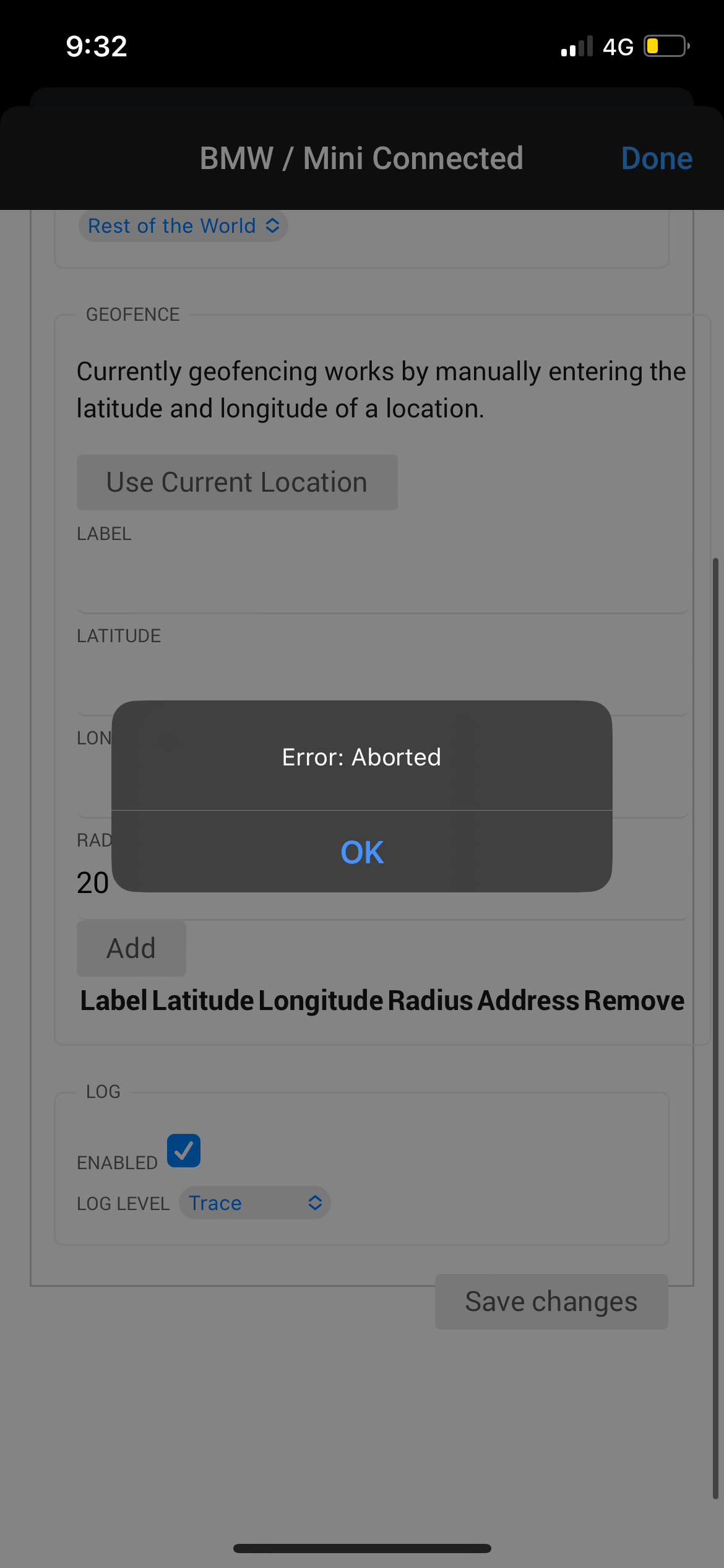

I’ve always had issues currently I get a aborted error
