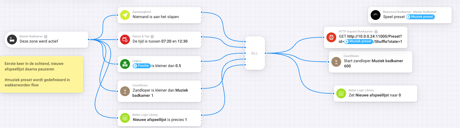

Ahhh this is very helpful and you can do the same as with the app (although it needs some more thinking). The good thing is that you can add shuffle as well, which was impossible with the Blusound app on Homey:
http://x.x.x.x:11000/Preset?id=[#muziek preset]/Shuffle?state=1
