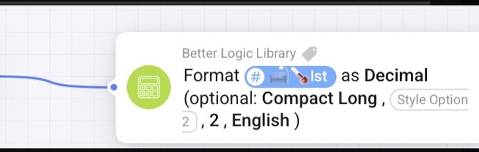

I’m trying to get my head around the functionality of your screenshot:
The first card returns the temperature without decimals, the devide part is superfluous when you multiply the result with the same value again.
The second card returns the “temperature without decimals” as temperature with 2 decimals.
What do you expect to change with the value from the temperature tag?

My floor heating system (Controme Smart Heating OS) is taking external temperature only if they are valid, based on the following rule:
Due to internal filters, Smart-Heat-OS only accepts temperatures (or humidity levels) that are divisible by 0.125. In addition, the API is limited to two decimal places, i.e., when transferring values with three decimal places, please remove the last digit (e.g., 22.0, 22.12, 22.5, 22.62, 22.75, etc.)
So the purpose of the flow is to get every temperature from my externals sensors as near as possible so that the Controme api will accept it by value and format.
Addition: Even if there is a value without decimals sometime the API is not accepting it without 2 decimals (,00). Strange thing…
I think I hear you.
So the API needs 2.00 as value and doesn’t always respond to a value 2?
That’s very well possible, but in the end it should accept integers (no decimals) imho.
round(12.12345 ,2) rounds to 12.12
but
round(12 ,2) rounds to 12, not to 12.00
So you add the 2 zeros with this card in that case?
Yes this is the purpose of the card

I think I’ve got it.
Each temperature is converted to a multiple of 0.125. Then it is truncated after the second decimal and always passed to the API with two decimal places, even if it is a whole number.
The external room temperatures now seems to be as near as possible with the given API of my Controme.
