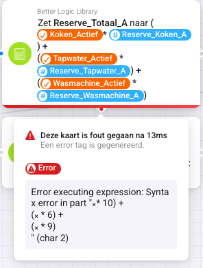

How do I use yes/no variable? I am getting a :cross_mark: of :white_check_mark:.
Put every thing between {{ }}
{{(koken actief*ReserveA)+(wasmachine*ReserveA)}}
Example:
MMM, I never used a boolean in a calculation.
It’s a bit confusing, but in Better Logic cards, used by Brian, there’s no need for the {{ }} around calculations.
@Brian_Monninkhof I as well think you can’t use booleans in calculations. You can use those in expressions, like
Which flowcard are you using?
Use the JSON Handler app for that.
I removed all yes/no variables, I use 1/0 instead.

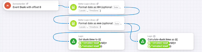

did it a bit differently in a different flow to extract the time of dusk which I use in different flows:
