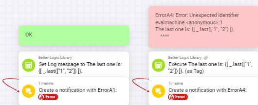

I think this is a bug or inconsistency in the flow card “Execute as tag”.
As per the example in the OP, I entered the below in the card and it gave an error.
When I enter the same in another flow card “Set variable to text”, it works.
It seems that the flow card Execute as tag does not accept non-BLL expressions followed by a BLL expression.
The last one is: {[ _.last([“1”, “2”]) ]}.
Well, it’s a direct Expression card.
BLL coding is an BLL expression within brackets to be used within text-arguments.
The Expression cards are for the direct expression, giving it the possibility to return any type of tag, like text, boolean or number.
I could perhaps check if the there is coding within a used expression card, and if so, eun it as text with BLL codings inside.
But then you would not be able to retrieve a text-tag with coding inside anymore.
I’m sorry I don’t understand. The text-tag is the reason I am interested in the Execute as tag card because the flow can continue with the real-time result in the tag. Much better than having to store it in a variable.
