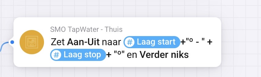

I want to combine two numeric tags into one string in the BLL card “Set text field to BLL expression” such as 48° - 52°.
How do I do that?
I was already making it more complexer. Thank you!

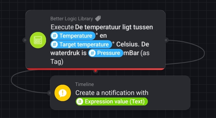

After some experimentation, it appears that this can also be achieved by placing the entire string between backticks, using the “Execute expression” card.

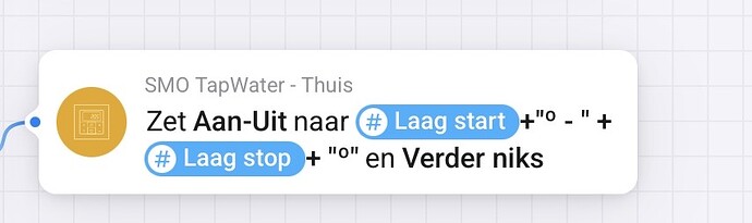

Regarding the quotes used in the expression: did you use straigh ones (") instead of angled ones (“)? My tablet inserts the angled ones by default, and they don’t work.
Maybe you can share (the part of) your flow that does not work, so we can read along.

the flow is ok, it was just the expression I needed help.
It works now:

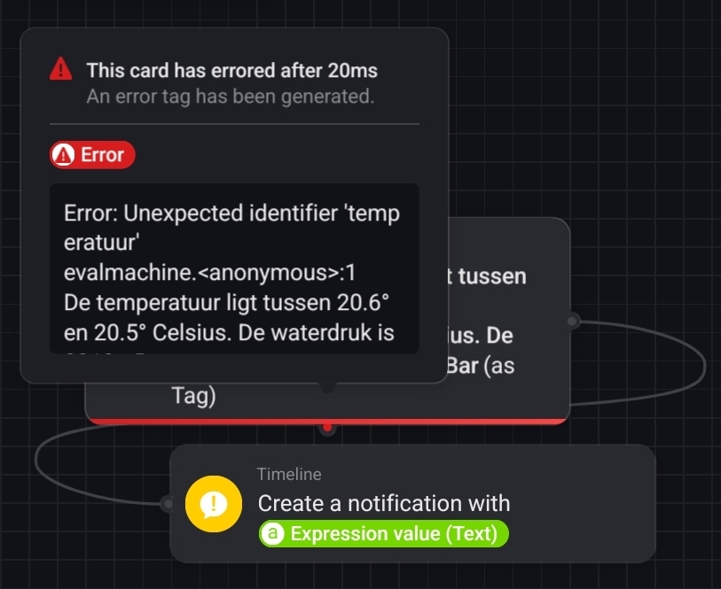

Hi Arie, I actually did try without backticks; maybe it fails because of running it on a Pro 2019?

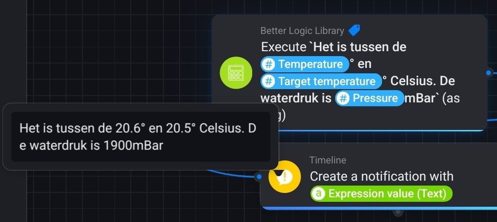

Between backticks:
No, you are using the “execute expression as tag" flowcard.
And that is precisely my point: for combining tokens/tags with text, just use the “execute text as tag" flowcard. You can just enter text than and combine it with flowtokens. No need for difficult quotes or plusses or whatever :wink:

And when using the expression card for whatever reason, it’ll just needs backticks for this to work.
