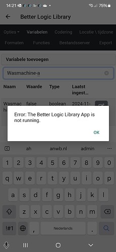

I am having a number of flows to see if a washing machine is finished. I created this based on some flows made by ? some years ago.
For some unknown reasons it stopped working. I am not getting the notification any more.
I started debuging and saw that the variables created in better logic are not shown in the app.
The names are still in the flow. When typing the veriable in the better logic app i get a message like attached. Does any one know why the variable can not be shown?
Dit you restart the BetterLogic App?
Yes i did
App Switched ON?
App Re-installed from the App-Store? (without uninstalling)
Done a PTP (= pull the plug for 12 minutes)?
Hi Jan,
Thanks for the ptp tip.
This worked and it looks it is now back to its normal behavior.
Regards
