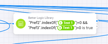

I couldn’t find a contain command but that “indexOf” is working. Here is an example that checks if bot Pref2 and Pref3 are not in text1. For those that need one :slight_smile:
This is a BLL logic evaluation card, btw.
