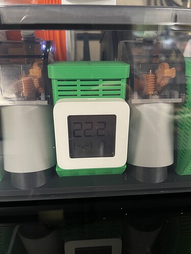

Do you have a picture of how you did this and with which sensor?
I printed some desiccant containers that can hold a Xiaomi temperature/humidity sensor (converted from BLE to Zigbee):
