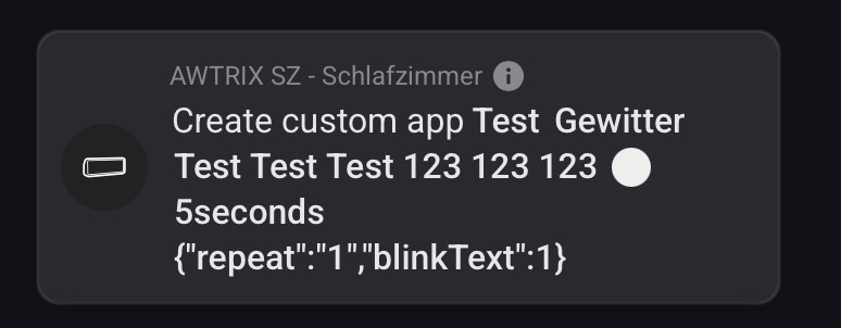

Thanks - just tested gradient as suggested
=> no gradient.
And also blinking without quotation marks:
Not working.
Thanks!
Hmmm, gradient works as expected, with this code it do exactly what it should…
Blinking work as expected too
Value 1 you entered is superlow, it means it should blink every 1ms, that is not possible for Awtrix, if you put 400 as blink every 400ms, that you will see blinks.
EDIT: But indeed it looks like repeat and blinkText does not work in custom app, i will try to fix it

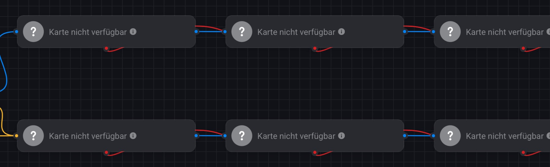

Just happened again:
bfcc5806-d5e8-4b5e-ab95-e940ace310b9
and this the flows are broken:
Also, I was wondering if there is a max string length for apps? Sometimes, my rather long DWD weather warning string is presented ā€œcut offā€.
Thanks for report, this looks like some sort of athom error that my app cant handle, error log said, the app is not connected to LAN ,i will try to speak with some smarter devs about this…
