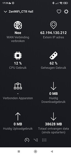

Added my mesh system successfully, but don’t see any connected devices:
201376ce-50ce-4787-845f-0325830af344
UPDATE
Removed the App, tried both the test and normal App version. Both install and allow me to add my mesh routers. They all show all stats, but not any connected devices. And, the stats are not updated.
