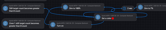

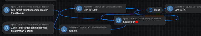

i am using these flows to test:
The 2nd one is in a computer bedroom and it shows its setup with 1 zone (did try other combinations of no zones to the 3 zones etc) and the same type of flows + a old one for just zone 1, In homeyPro it doesn’t detect anything but mbar,LX, and Uv. I have reset it using the wiki guides, to make sure its on a good wifi connection, i tried different cables and charging bricks, i tried the Restore Factory button on app and nothing works? does any one have any ideas of what i could be doing wrong? i tried to go to the website to go in my account to see if they would replace the one i have issues with or let me upgrade to the The Apollo Automation R PRO-1 PoE mmWave Multisensor (LD2450) if that sensor would be a better choice, but the website is blocked my antivirus so im hopping someone can give me some help since it seems like HA is well documented on using it, and me having to stand close the sensor to use the radar app in one room, then test advance flows on my PC takes some time and so i want to make sure i’m doing this right
