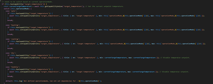

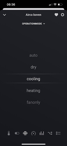

Something the mobile app āhangsā when switching( when switching operationmode some capabiltyoptions will be set)
You need to go back to the device overview en reopen the device again.
This is not a problem of the Daikin ONECTA app, please contact Athom.
Hi Mickel,
I already tried to restart app, forced closed the Homey app, so obviously reopened the device, but still no temperature setting possible. Iāll get in touch with Athom also but I already know what theyāre going to say
