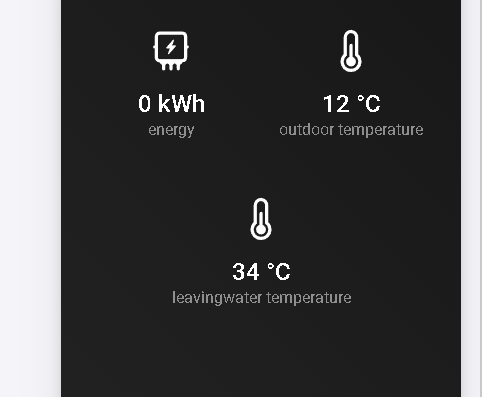

Maybe I missed something …
The “Set the temperature card” controls the temperature of the ˵leavingwater˶ (34℃),
I would expect this is to set the thermostat temperature. (in the room with the thermostat: 19.5℃)
How can I set the set the thermostat temperature?
Set temperature
Yes, this is a bug reported by antoher user already
Already identified this faulty code. Making a fix at this moment
Wait for the next (test) release probaly today.
@Ruurd_van_der_Noord : can you check if issue is solved with test version 6.0.6?
yes will try …
App version 6.0.6 installed and restarted.
But leavingwater is now 19.5 … which should be 34, and thermostat 19.5.
Wait a minute, restarted HP2023 and test again …
for a short while it seemed ok, but not now back again.
So confusing … Will perform testing again a few times and will come back later …

For now 1 issue with with set temp interface card.
Will perform the test once more a bit later.
Result confirms latest found values.
Correct results for Daikin Android App.
HP2023:
1 issue seems left with set temp interface card. (20-45), easy to workaround though.
[the physical thermostat does not always respond, but I can imagine that with all the rapid changes.]

version 6.0.7
issue for Set temp interface card. (12-30) solved.
Thank you so much …
