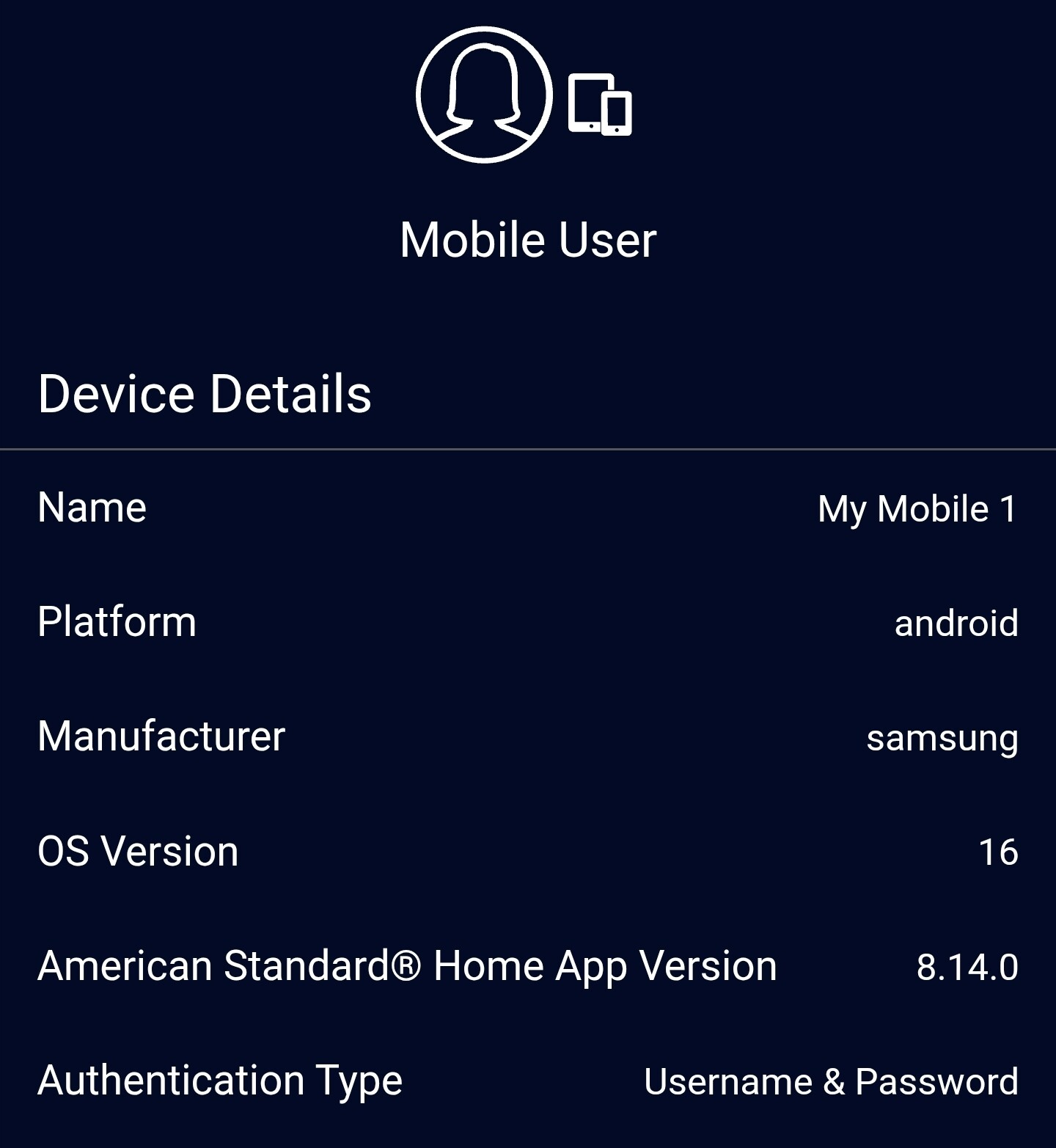

Do you use the American Standard Home mobile app on your phone, or an older “Nexia” app? Or maybe you need to accept some kind of updated ToS or Privacy Policy before you can continue using the app?

  • Updated mobile app version number in login
Should be fixed now, please install the latest version and try again
