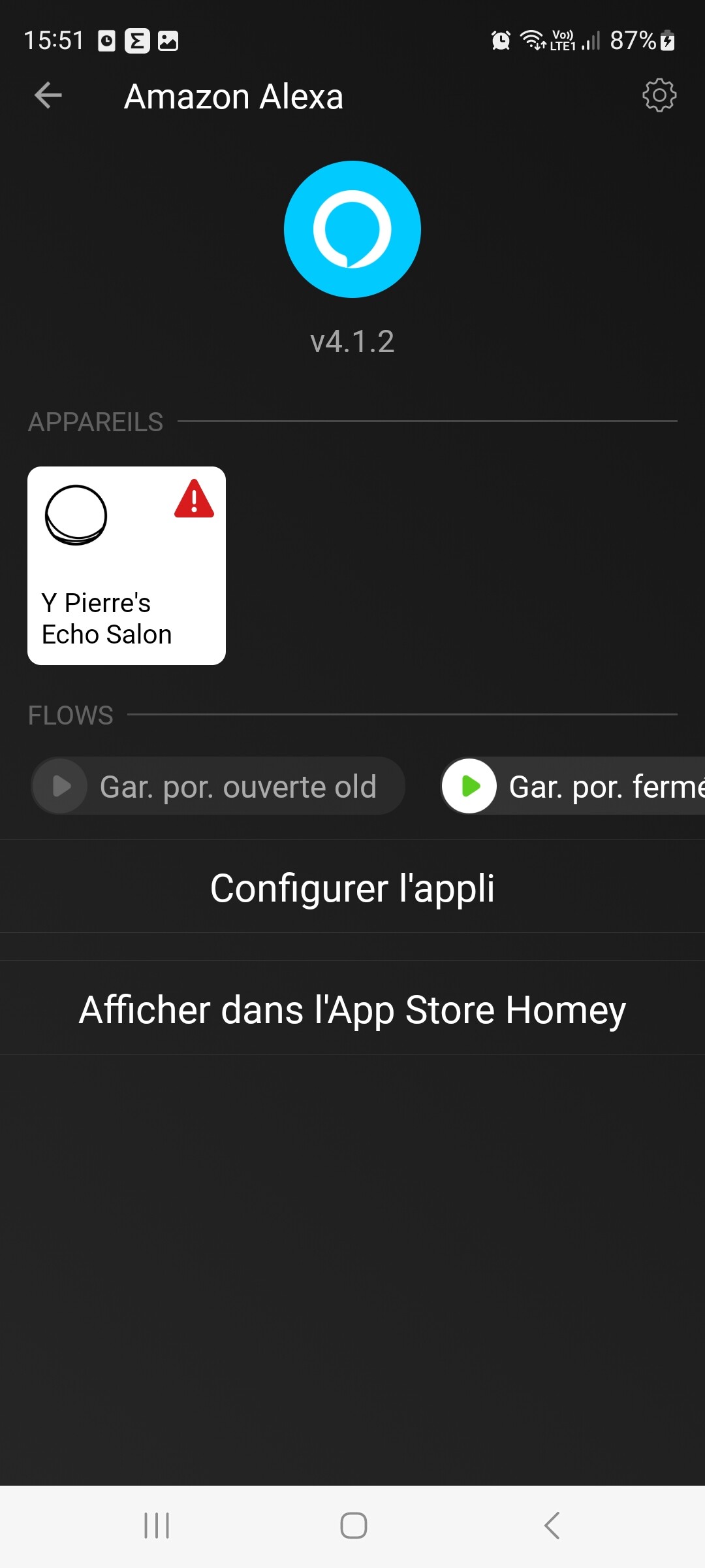

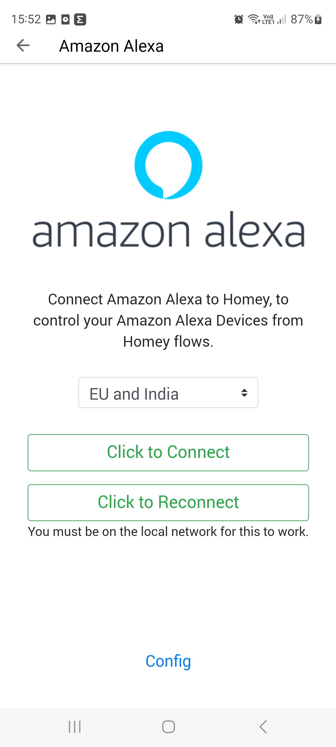

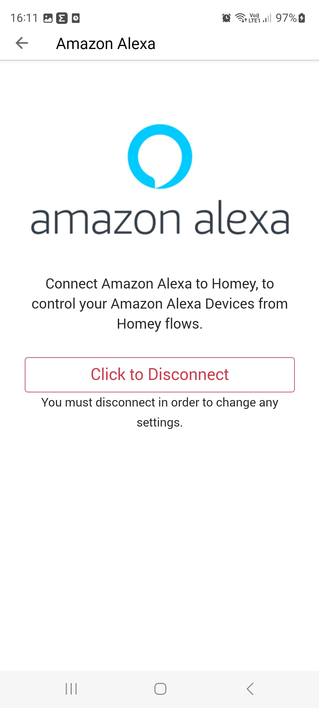

Can you show when it says to reconnect in the app settings, and the not found part please.
As you can see in the last picture Iâm supposedly connected but when I go back to Homey, Alexa is still disconnected.
Sometimes it would just reply âImpossible to connectâ.
