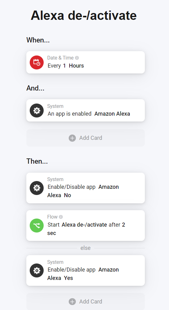

I was not precise enough. I do not use the restart card but the Enable/Disable card:
Maybe it works better, good luck!
