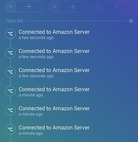

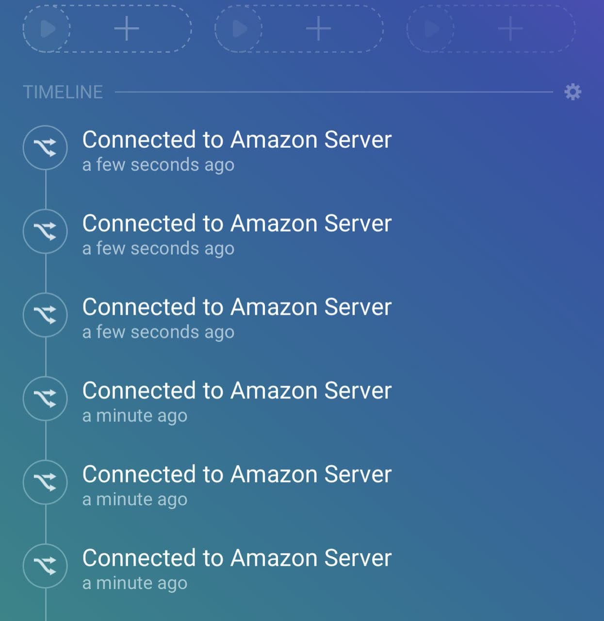

Now getting messages instantly, and lots of them, not just every 15 minutes but multiple every minute (i do have 3 devices connected, so that might be why i get 3 mesages a minute)
Thanks again for you effort, so it seems to be the normal behavior at the moment.
And in my case it triggers also in sec not min. You can type on âa few seconds agoâ in the timeline to see the date/timestamp in detail.
The question @Jamie : shows the card real reconnections or is it a loop in the code?

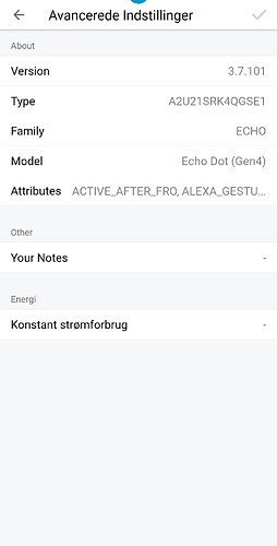

@OWA My dot 4 that is an invalid device as well without clock. Maybe itâs a matter of country settings, could you post you 3 alexa country settings right of the app settings?
Of course. I live in Denmark but I use the US Server. Please let me know if I took the correct screenshot
