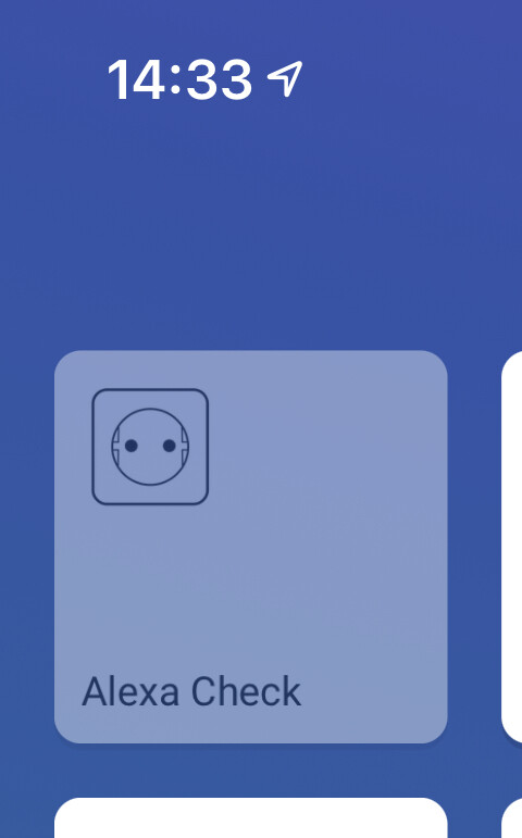

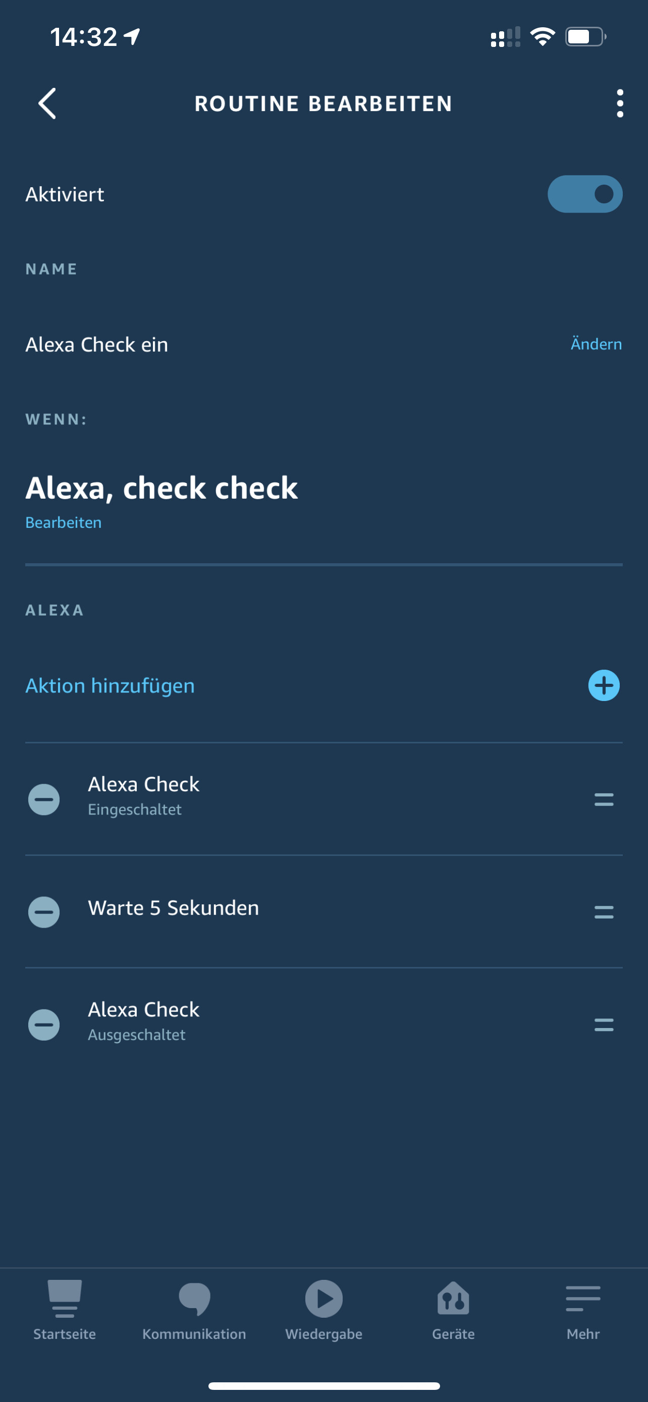

Hi @Ricardo_Nunes in my case it s working more or less without problems. Sometimes i have to restart the app but i did a flow to supervise the connection and if broken it will restart the app automaticly.
Basically i trigger a routine on Alexa (via Homey) to turn on and off a virtual socket on homey. this will happen every 15minutes. After turn off the virtual socket a countdown is starting. Everytime the routine turn on the socket it will reset this countdown. If the connection is broken the countdown will expire and restart the app.
