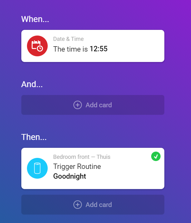

Routines work fine for me, did you setup a routine to open the garage in Alexa or in Homey? If i setup a really simple flow in Homey to trigger a Alexa routine to for example turn off the lights, all seems to be working fine. Could you test something like this and see if that works?

So you have a device on Alexa that you can trigger with Alexa voice commands but if you make that device part of an Alexa routine it doesnât work? Also not with a voice command? Or canât you get the routine to start from a Homey flow?
Just to be clear, also voice commands for routines donât work, only voice commands for devices? Or did i not understand correctly? Itâs not entirely clear to me what the exact issue is i guess

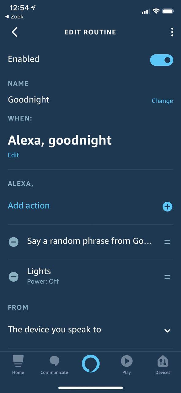

Alex works perfect:
devices - work
Scenes - work
Routines - work
Voice commands - work

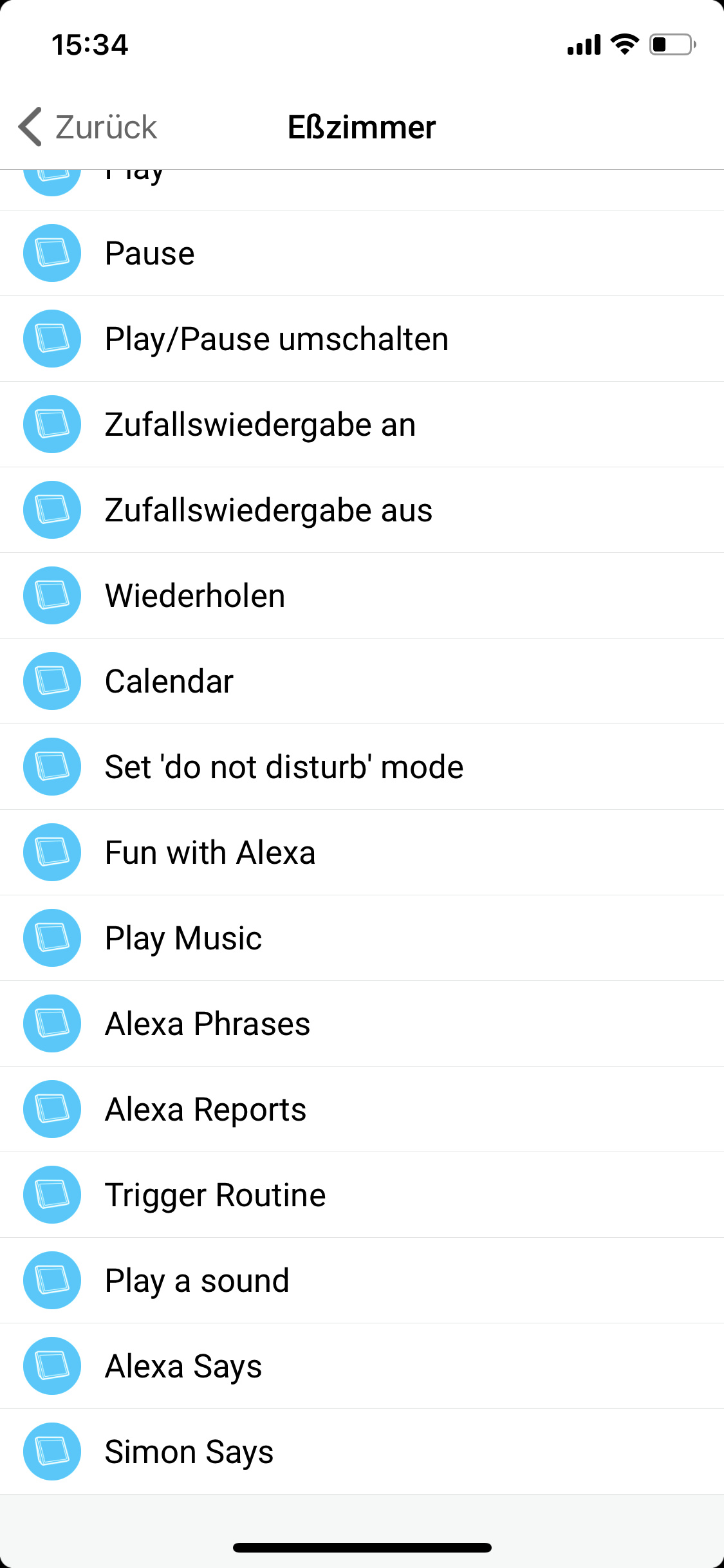

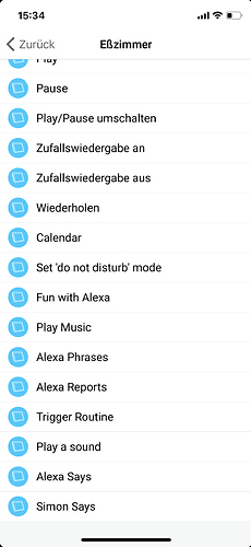

Triggering any of the Alexa actions(picture) offered by homey when you create a flow and select the Echo-device ( play, pause, phrases, reports, Alexa says, routines) - no reaction by Alexa
ah okay, thats strange, i use these flowcards and for me they do work (except for a small issue with music on multiple devices. I see in your image you are using a Amazon Show? I use the Echo, so could have something to do with that maybe? @Jamie
