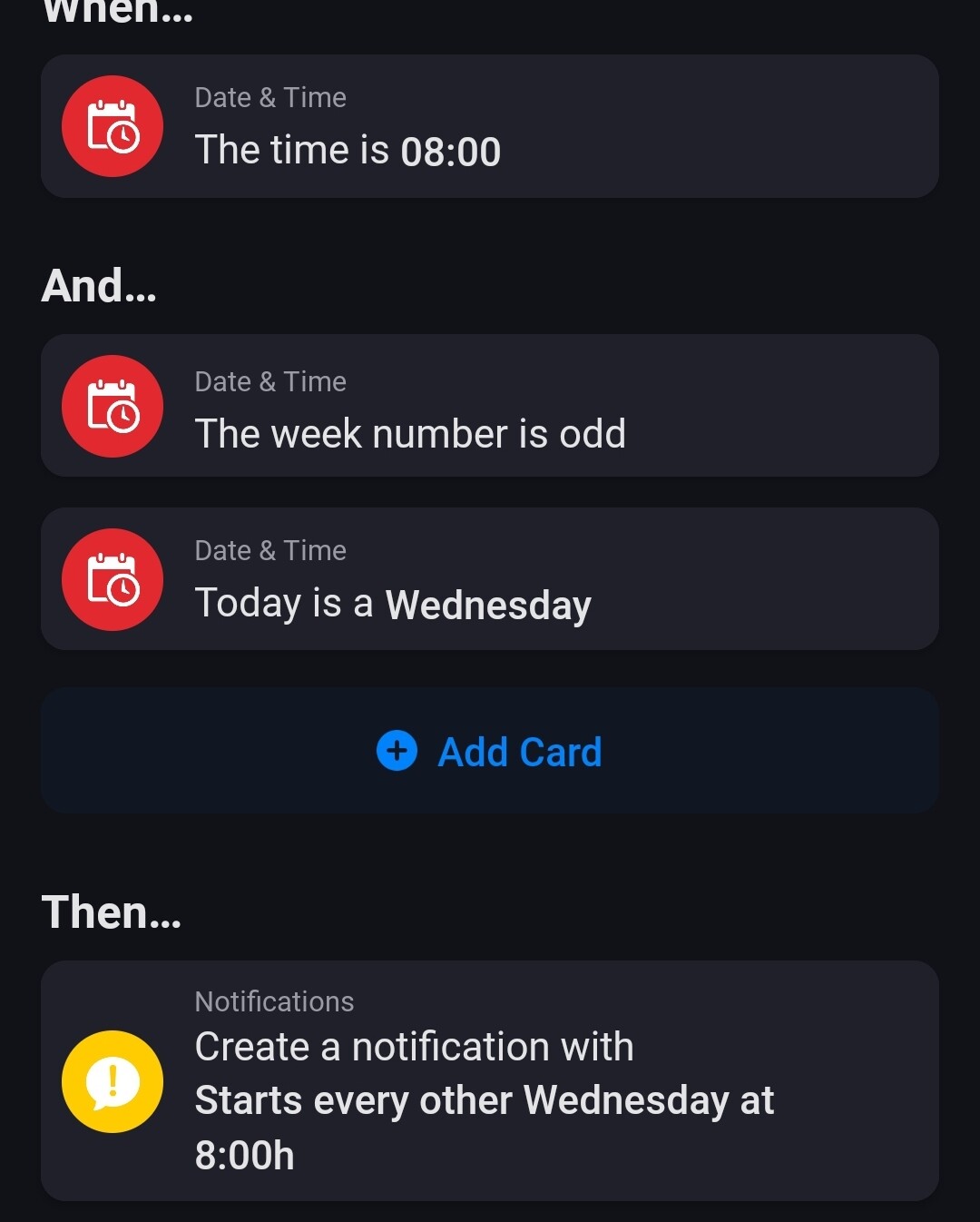

Unless it’s my own lack of understanding of cron, what i can do with cron is to schedule the job every first and third wed, or the second and fourth wed, but the cron job schedule breaks when it moves from a month with four Wed to a month with five Wed.
My bad, I just had no doubt cron should be able to do that easily. But from what I’ve read exactly this is just not possible with cron.
But, you can do it the Homey way, without any app:
Just trigger at the desired time, and filter on day and even/odd weeks.
Wow thanks! This is a nice hack!!
