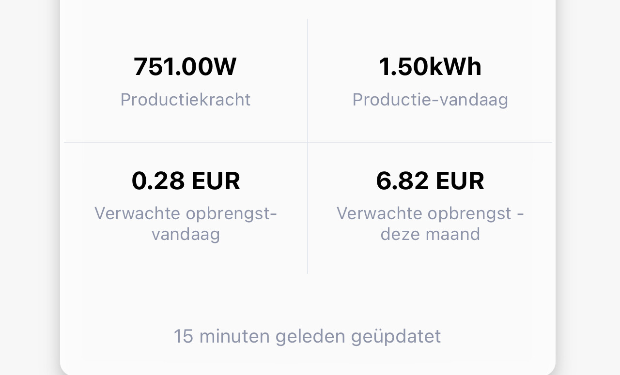

On my Solarman app total today is 1,50 on homey it’s 0,80
Uploading: IMG_3113.jpeg…
The history updates once per hour.
The other data updates every 15 minutes.
