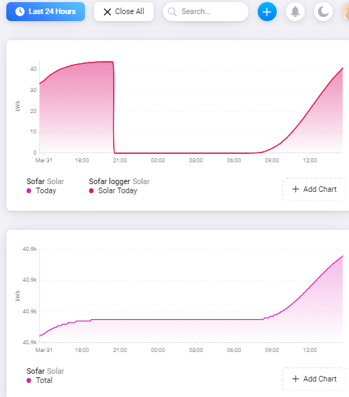

I mean the field Total in the inverter panel (not the logger).
It thought would be possible, as the fields Solar Today (inverter) and Today (logger) have two decimals (I am not in favor of using these fields because they are 0 when no sun, see graphs: it’s unclear to me how and when it becomes zero after a day of sun).
Update: I did some more tests and actually applying the app for trend calculation on power (W) is not significantly different than looking at kWh positions.
I see what you mean, meter_power is a whole number :sleepy::
