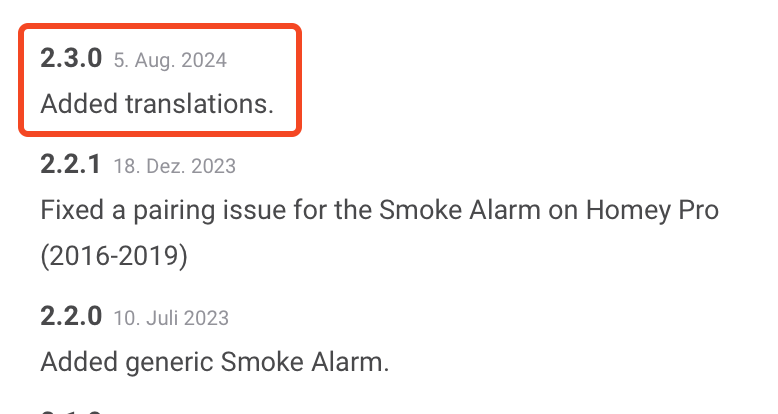

Just for your information, which you probably could find out for yourself.
The last update of the Nexa app was on August 5, 2024:
Therefore, the app can usually be ignored as a source of the problem
On July 03 or 04, 2024 the firmware version v11.1.2 for the HP23 was released:
Because you mentioned 2 dates, it’s not clear if the firmware update could be the cause of the problem. However, the changelog doesn’t mention any changes regarding 433 MHz and cloud services. But this is definitely no guarantee that Athom didn’t changed anything regarding 433 MHz and cloud services. Nevertheless, I think that the firmware can also be excluded as the source of the problem. Especially because several new firmware versions have already been released since then.
