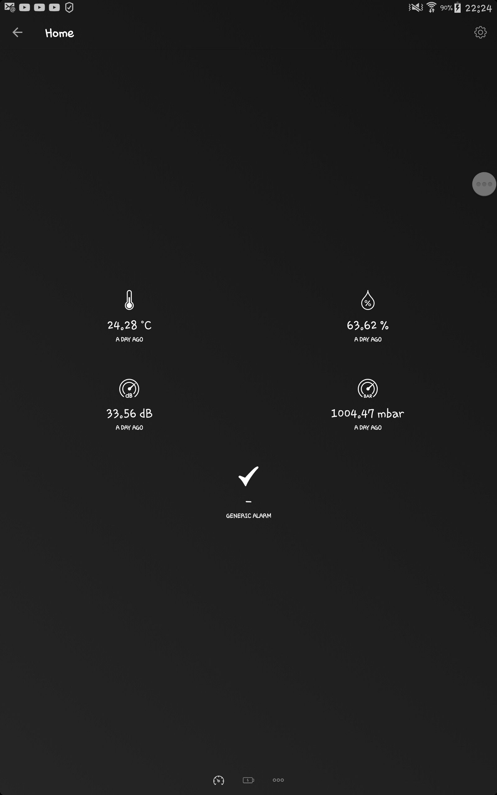

I see the app updated but the problem is, it does not update the data, see picture. What i do wrong? Thanks for Help.
hello @Tolga,
This js my bad. i should have added some explanation with this update.
due to the rebuild of the app, devices should be readded in order to have them receive data again.
this is also stated my M_a_r_c_o in his previous post.
sorry for the inconvenience.
kind regards
ketra
