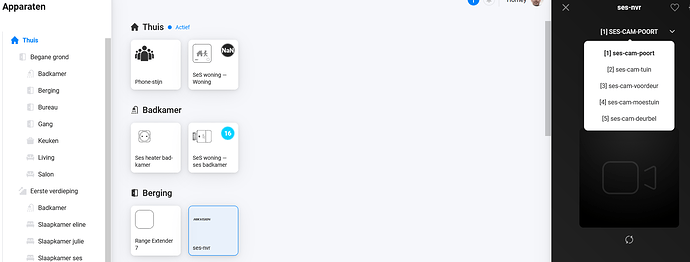

Hi Hiato,
I have the hikvision app installed in homey and I have the following.
as you can see i have a dropdown list with all 5 camera’s I have from hikvision.
Other solutions:
  • use the hikvision app directly (hik-connect)
  • use the onvif app in homey
hope this helps
