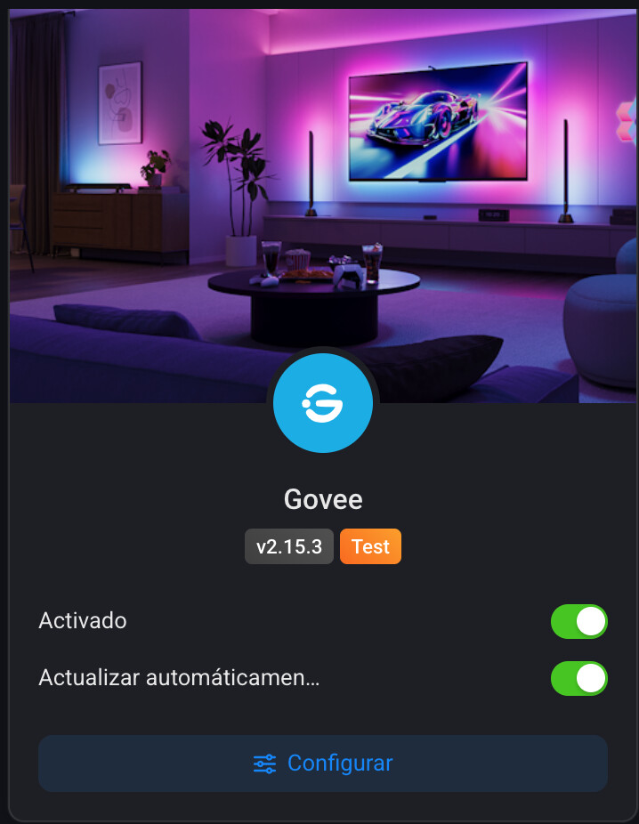

Hello, I am new to the platform. How do I install the test version? The installed version is v2.15.2.
I have tested with Wi-Fi and with the official Homey LAN adapter, and in both cases, I get the same result: it doesn’t find the device.
My native language is not English, sorry if I’m not expressing myself correctly.
Thanks
Now i have the test version but not detect any device with local API
