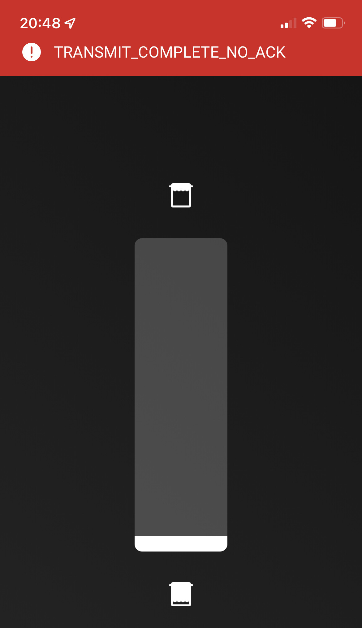

Here also the issues with the last update, since 3.2.1 het fgs-221 modules aren’t working anymore, all report as unreachable in the dev console. Sending switch command give “no ack” message. Anyone have an idea how to go to the old version of the app?

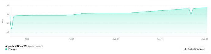

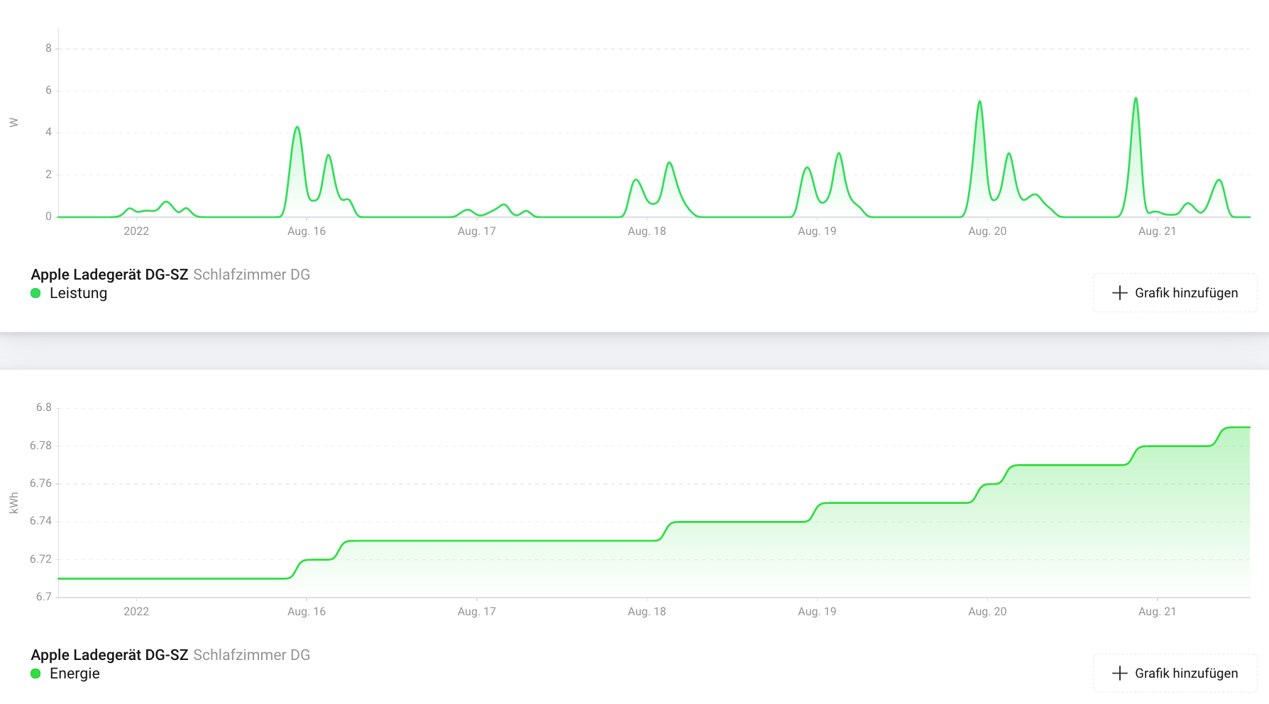

Could it be that wall plug 2 is not reporting the power consumtion and energy values?
When you write wall plug 2 I guess you mean the wall plug FGWPx-102-PLUS, right?
All my 6 wall plugs (FGWPx-102-PLUS) report power consumption and energy values:
But sometimes peaks (+ and -) can be seen when logging the energy consumption. However, these peaks do not seem to have any real influence on the total consumption.
right I use this but the diagrams are empty thats why I am confused.
