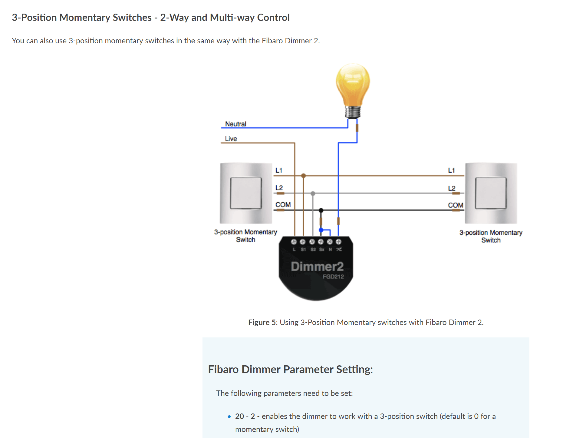

Can someone advise how in homey I change parameters for, say, the Fibaro dimmer?
Iām just looking at some wiring diagrams (thanks to vesternet) and the following is the setup I want:
It says I would need to set those parameters - before I dive in I want to confirm that this can be done within Homey interface?
Thanks!
(almost) all parameters are in the deviceās advanced settings, this is for any zwave device.
And yes the parameter of the dimmer 2 you want to change is in the advanced settings.
Fab - thanks for the confirmation
(side note, is there any way to preview these options without having a device to hand?)
