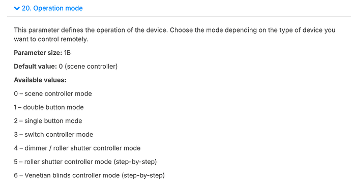

I don’t understand exactly what you want to do. Do you want to connect the Walli Controller to the Walli RollerShutter via association? And which functions exactly should be controlled?
Here are two screenshots of the manual which settings has to be changed:
This means that you have to enter the NodeID of the Walli RollerShutter in association group 6 (for roller blinds) or 6 and 7 (for venetian blinds) in the advanced settings of the Walli Controller.
You must also set parameter 20 to 4, 5 or 6. However, as the parameter 20 is not available in the advanced settings of the Walli Controller, this parameter must be set via Z-Wave raw configuration.
But it’s possible to do it in the advanced settings of the WC. In the menu Z-Wave raw configuration parameter (hope this is the correct translation) you must enter the following value:
ID = 20 (ID of the parameter to be changed, in this case Operation Mode) [*1]
Size = 1
Value = 4 (RollerShutter Controller) or 5 (RollerShutter Step-By-Step Controller) or 6 (Venetian blinds Step-By-Step Controller)
Complete value = 20,1,5 [*1]
[*1 corrected]
If you are using battery mode, the WC must be woken up before saving the Z-Wave raw configuration values:
