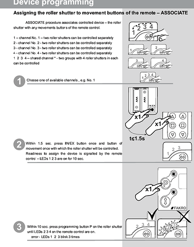

hi Alex, I don’t exactly know what you did and what is visible in your screen while you are trying to do the associate action. So from here, it’s really difficult to tell. But since the user manual of the ZWK10 seems soooo similar to the ZWP8, i am pretty sure it must be doable, following the instructions that I included above.
Hello!
I set up a roller blind in Homey. Then I followed these instructions:
The setup always stops in step 3 after 10 seconds.
