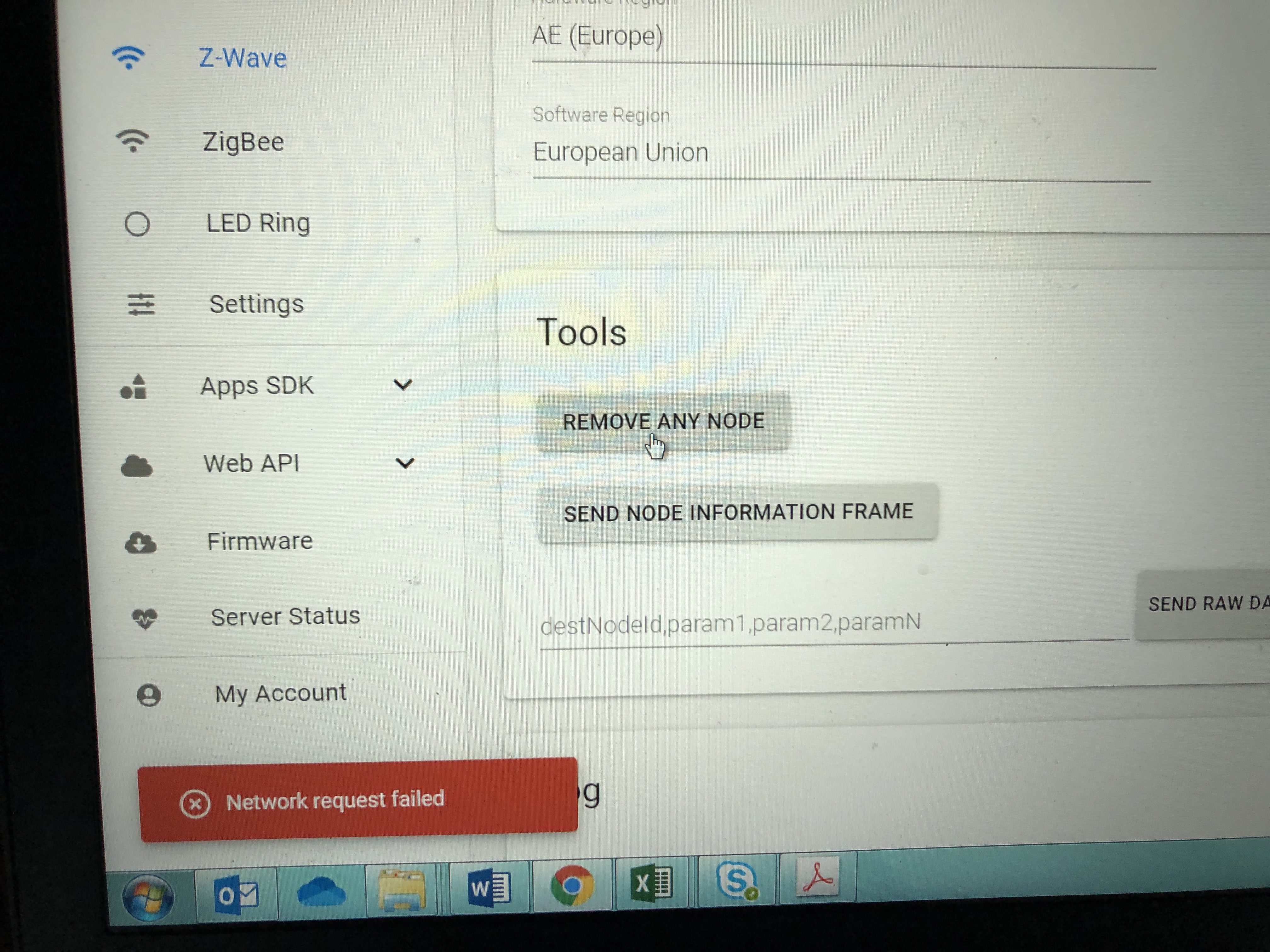

https://developer.athom.com/tools/zwave
Remove any node and put ur device in inclusion mode.
Yep tried it and I get the message network request failed
I have send a contact request to Athom. Maybe one more thing to try; My Homey is powered via a USB port (not the Homey power plug), can it be that this does not deliver sufficient power for Z-wave?
Just make sure the power is at least 2.0 A !
Didn’t work
 I think I might have a Homey hw problem
