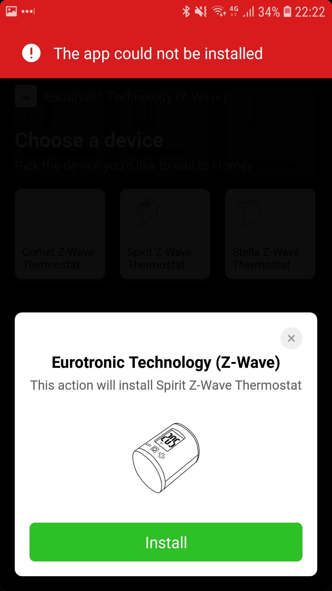

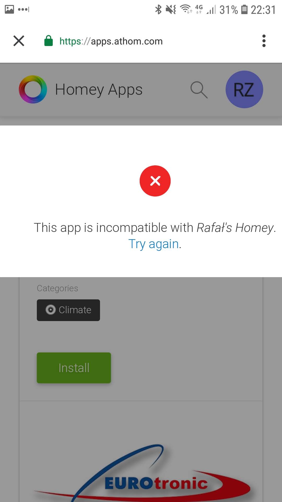

I have just bought Homey and tried to install first devices, including Eurotronic Sprit thermostat valve.
However when I tried to install the Eurotronic App via “Add new device” in Homey, I got an error “The app could not be installed” on the red background. When I tried installing it via apps.athom.com, I got “This app is incompatible with Homey”.
What’s wrong? How should I debug those problems?
Screenshot_20190416-222300_Homey
Screenshot_20190416-223146_Chrome
The original app was Published before the Homey 2.0 release,
The developer has update the app and published a beta version click on the link below the logo to switch to the beta or wait until that one is released as stable.
Thank you, beta version works fine!
