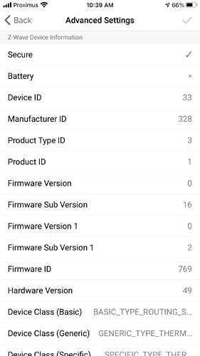

All the devices are running on FW 769

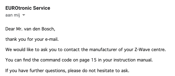

Received a response from Eurotronics, after 5 months:
Am I happy?

Have you seen the advanced settings of your valve?
There is a setting to enable report of the manual position, it is disabled (value: 0) by default to save a bit more battery life.
