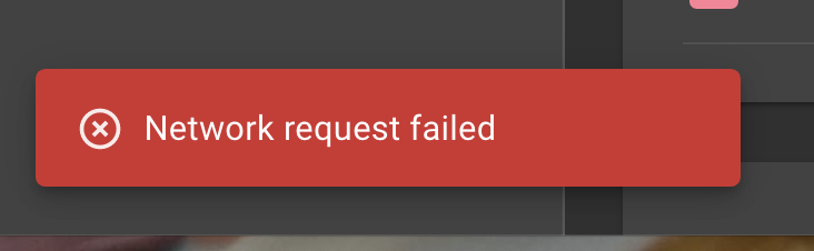

If I ‘test’ it, I get:
If i ‘heal’ it, I get:
Tried this with all four Spirits. All will ‘test’, only one will ‘heal’. Odd…
Looks like only the Kraan bureau cv is not accesible. Did you check the zwave settings to see which route the Kraan bureau cv is using ?
i assume the devices for the cv are not powered so depend on a zwave router device.
I you would have a zwave powerplug or a bulb you can maybe test it in the same area as where the Kraan bureau cv is.
can you read the device’s temperature ?
