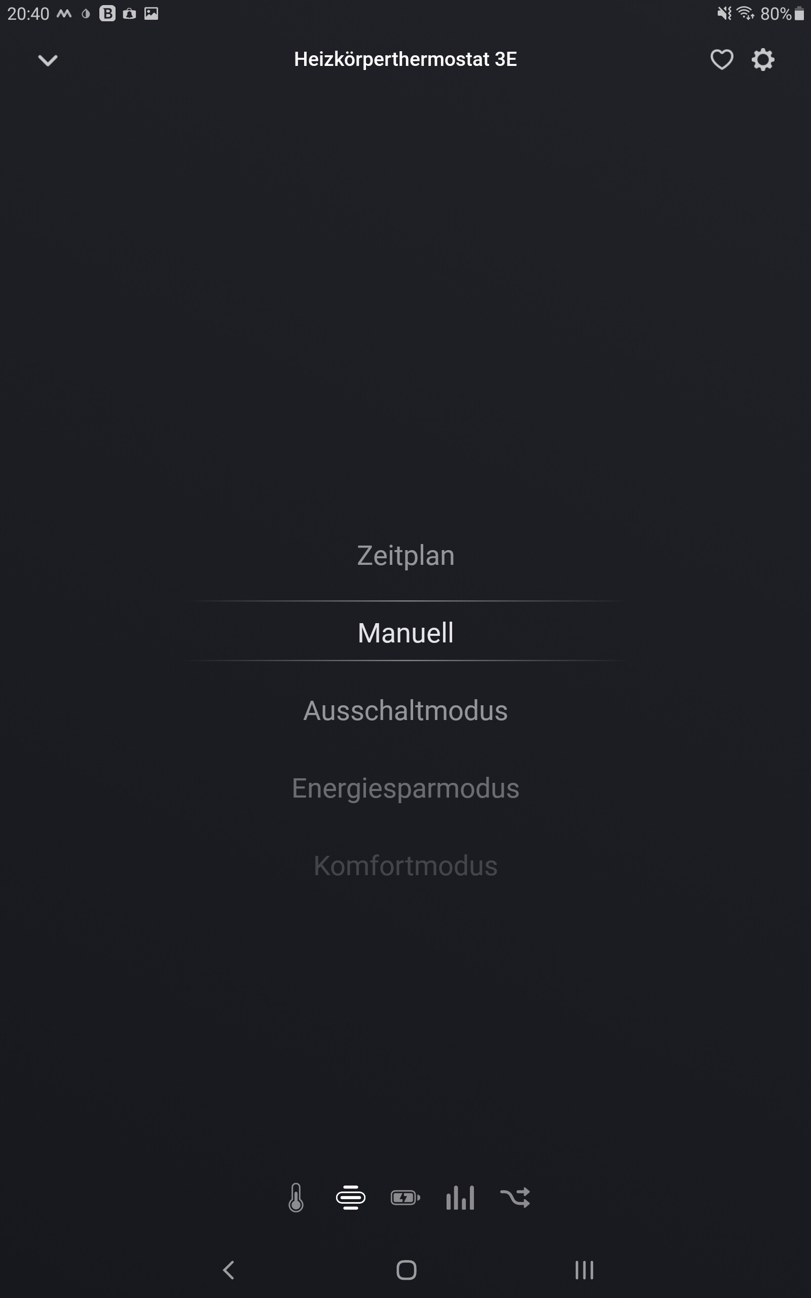

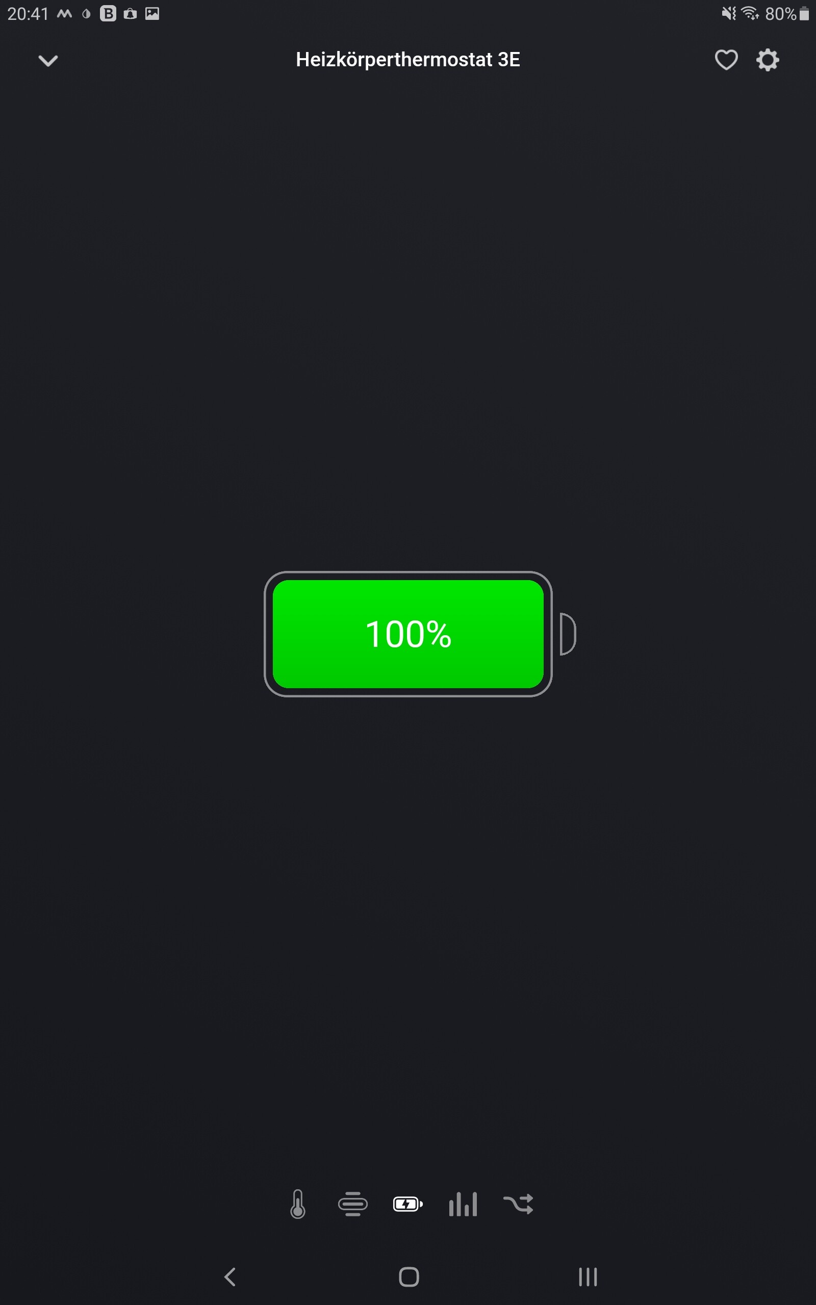

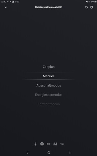

No Problem:
Thank you for confirming. Hopefully I will publish a test version this evening as I had most of it in place this morning before work. I just have to link up the custom mode capability to the function and create the Flow cards.
I have published a new test version. I haven’t been able to do much testing on the Radiator Thermostat as I don’t have one, yet. I have ordered one from Amazon, so maybe I will have one by Friday.
I tested it. It works just like the connection via Matter! Great !
