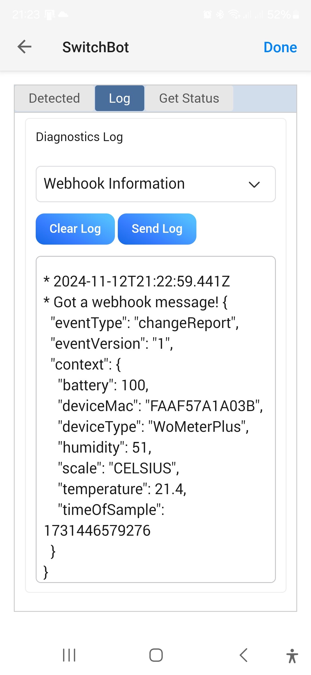

Hi just bought some temperature sensors (plus and pro), connected via hub mini. The switchbot app always has the right values of the sensors. Homey only updates after I reboot the app… So not doing it automatically. Any tips please? Thanks!
Can you open the app settings page and select the Log tab. Then set the log level to Webhook and monitor it for a while. You should see reports coming in when values change

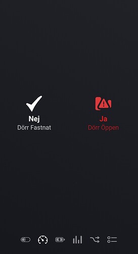

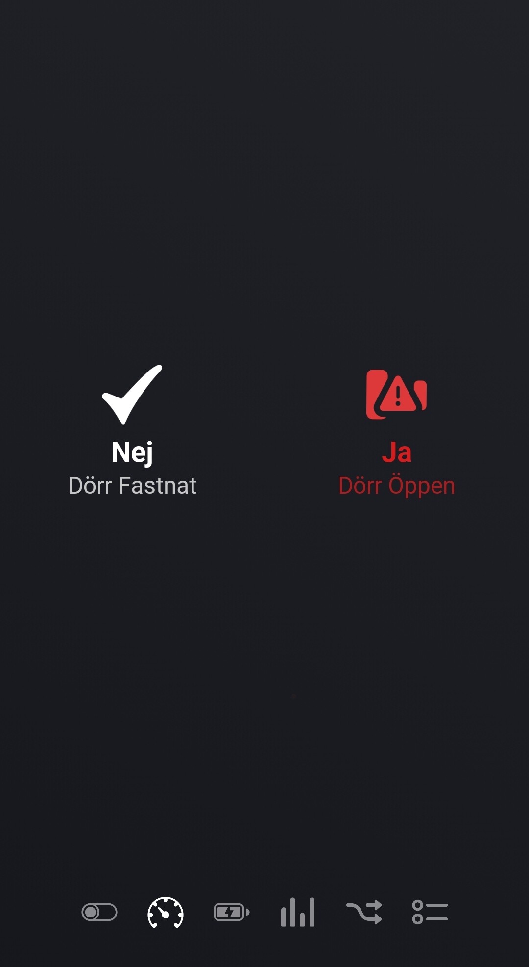

Why does it show that my door is open when it’s not?
The Open / Closed status is not updated via a webhook so the app has to poll for that information. How many devices you have that rely on polling will determine the polling interval so the app doesn’t exceed the allowance. Therefore the status might take a while to update.
If you look at the Log page in the app settings and set the level to Detailed Information, it will show you when it is polling and how long it is to the next poll.
@Adrian_Rockall is that the SwitchBot app or the Homey app? I guess SwitchBot, I’m not at home and can’t get all info since I’m out of BT range.
According to Homey the door was opened a month ago…
It’s in the Homey app.
I see now that they are getting data, and values are changing in homey. However it’s a little random. I have one saying “one hour ago”, another one 22 minutes ago and one that says 2 minutes ago. Can we change the speed of the polling or interval somehow? Thanks!
The app isn’t polling for data from those sensors, it is pushed by SwitchBot and received by the Homey Webhook. So the timing is determined by SwitchBot, but is normally when a value changes.

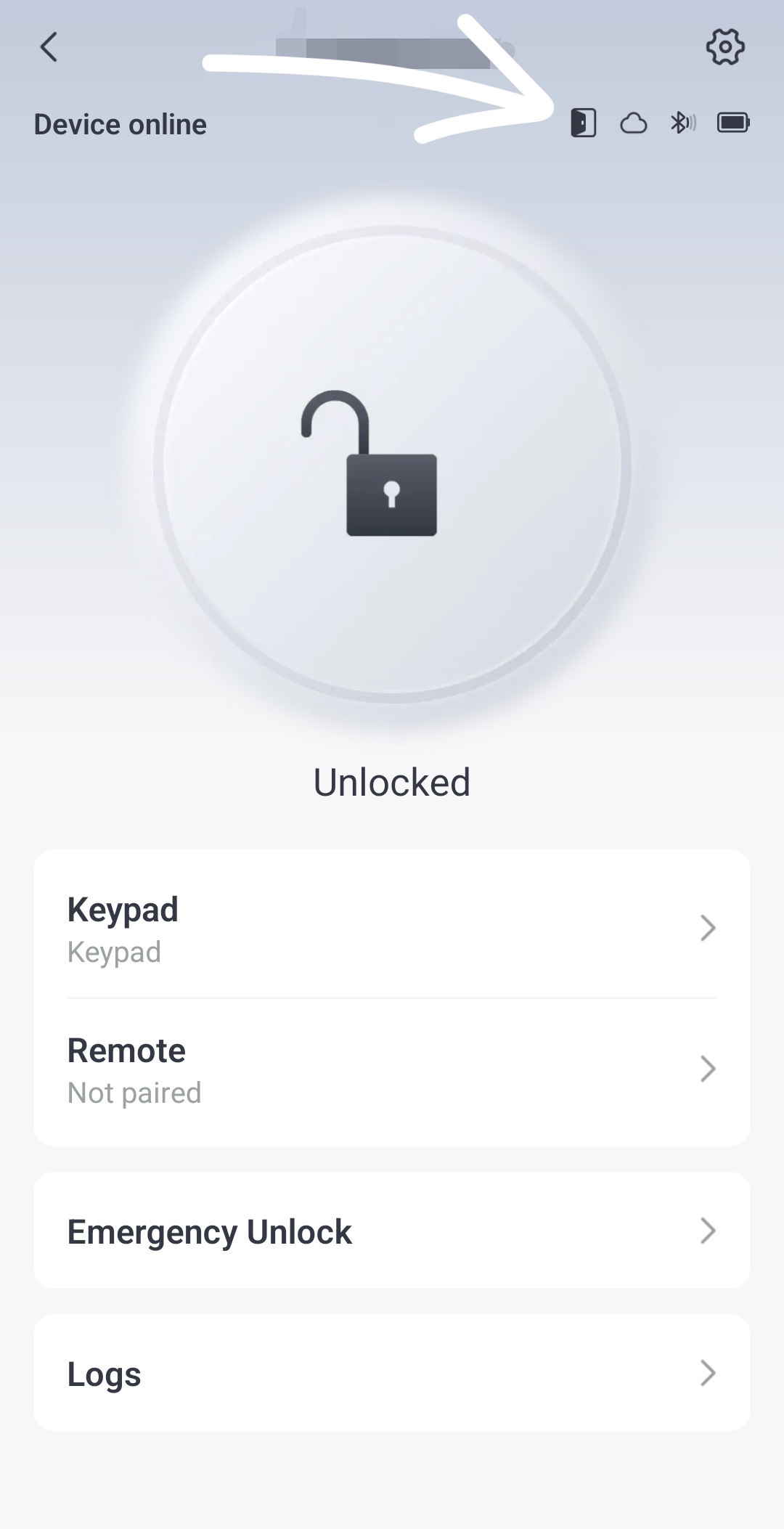

In the SwitchBot app, does this indicate that the door is open?
I took a magnet all around the lock just to see if I have mounted the one included in the wrong spot, the icon didn’t change.
I’m not sure as I don’t see that icon
Do you use the SwitchBot Lock or the Lock Pro?
I have the Pro.
I only have the old one. However it does have a door sensor and it reports in Homey, but takes around 45 seconds to update due to the number of devices I have that use polling.
Where do you see the sensor in the SwitchBot app?
I can’t see it. But I do get a notification if the door is open for too long.
