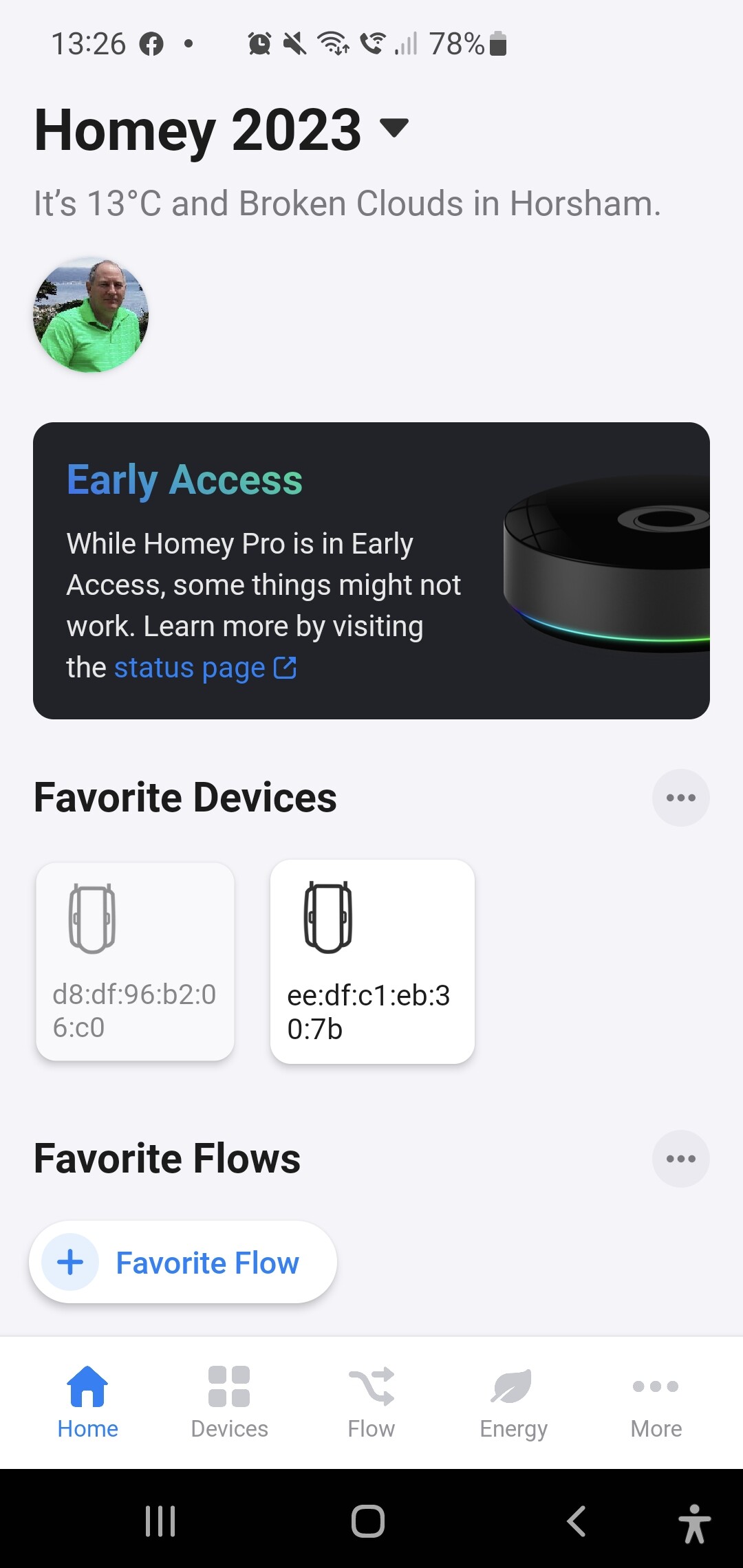

I see this;
My apologies. I had forgotten I had my ESP32 BLE module running and that was how the devices were being added.
I can see now that the new Homey 2023 returns the long UUID instead of the short UUID (fd3d), so I will need to change the logic from === to a ‘find’
I will publish an update ASAP.
Hmm, update might take a bit longer. I can now add my devices directly to Homey 2023, but controlling them fails most of the time as the homey.ble.find( function immediately throws an error if the device is not in the current discovery list. It should check the list first and if it’s not there perform a discovery and check again. Issue is reported to Athom so will wait for an update.
