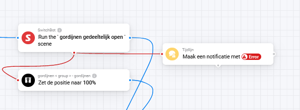

I created a temperally work around for it using advanced flows, if an error occurred using the (hub) API i use BLE connection to open/close the curtains (are grouped) and write a log so i can check what went wrong.

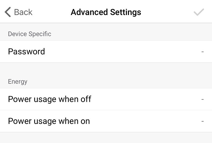

Hi! About the switchbot BOT (pusher), I didn’t see the option to turn it on OR off. It’s only a ON position (and turning off automatically).
I would like to keep it in ON and choosing when I want to turn it off.
I am using the sticker to use both on/off position.

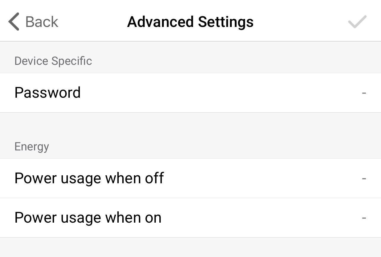

If you look in the Advanced settings for the device, there is an option to set it as a push button. Make sure that is switched of.
Thanks for the reply!
I don’t have this option. Maybe this is not in the BLE mode? I am using the direct BLE integration (no mini hub).
In BLE mode it operates the way that has been configured in the Switchbot app.
Correct! Thanks for the info! Very helpful.
