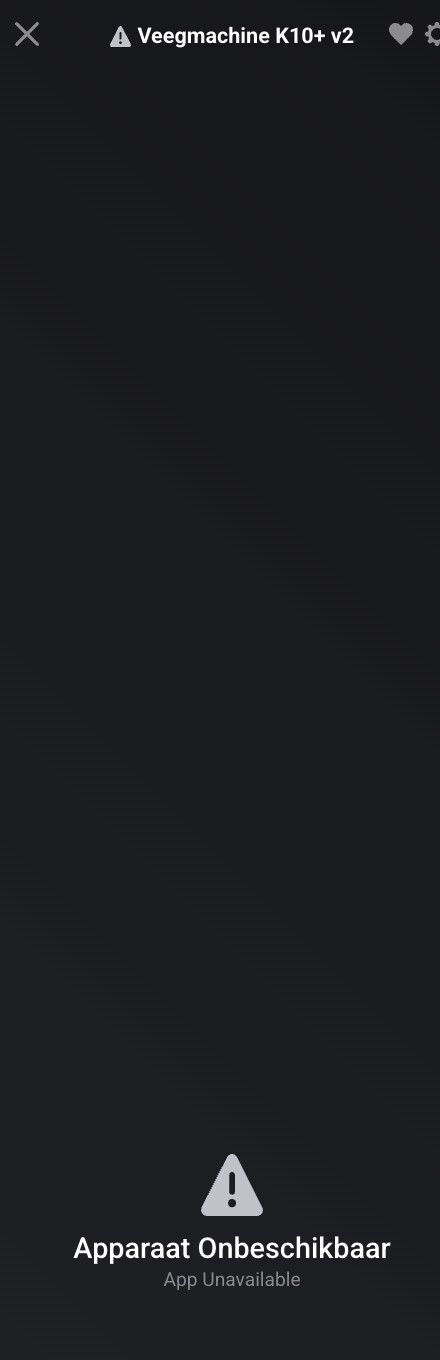

Since the last switchbot update the vacuum cleaner stopped working. The other devices seem fine, and in the app I can still retrieve its status:
workingStatus: ChargeDone
onlineStatus: online
battery: 100%
Could you try deleting it and adding it to the app again?
I think I have inadvertently made a breaking change by fixing a spelling mistake :flushed_face:
