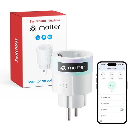

Is there a possibility to add the functionality of trigger/start the delay (on/off) function of the Power Plug mini (EU).
So like in the switchbot app ?
Please. :folded_hands:t2:
(And if the plug (and Presence sensor) ever becomes available as BLE this (combination of these 2 devices) would be making a massive impact because it could open up to so much (reliable and not cloud dependent) potential/ possibilities).
(By the way , I never saw the plug mini (EU) cheaper then now (as 4 pack) on Amazon(.nl) on Black Friday:
(its a real “steal” imho. )
(I need some (BLE plugs to be capable to be turned off and on (by Homey) when the internet and/of wifi is down/unavailable to restore the internet/Wifi by restarting the modem/router/wifi (poe power) by power cycling them through these power plugs automatically/by flow).
