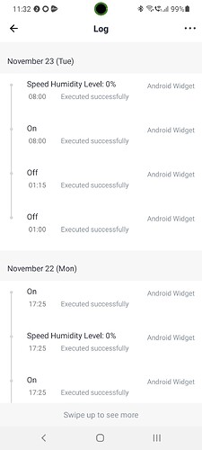

@Adrian_Rockall can you maybe tell me why this flow does not work?
https://homey.app/en-us/flow/nnpmcR/
The IF (en) statement is met, also log is written but the humifidier itself is not running, when i open the log in the switchbot app then i see the following (see screenshot nov 23 8:00u).
The strange thing is i have 2 flows (other one: Shared Flow | Homey) to start the device and both do not work properly, all ‘if’ statements are met and still the device does not go on. (light is still off on device, normally i is on when running), what is this level at 0%?
When i start it using the switchbot app itself it works fine.
Also in Homey the device state is ‘ON’, so a second flow which only starts when the device is ‘OFF’ will not trigger.
I try to get a decent flow which turns the device on when someone is at home (specific zone and specific logic values are or get active) but can’t get it to work properly…
You have a tips?
I will have a look this evening but it looks like it might be a bug as I think that 0% should be 50%.
Does it work if you set it manually via the Homey app?
I have found the problem and will fix it and publish an update this evening.
